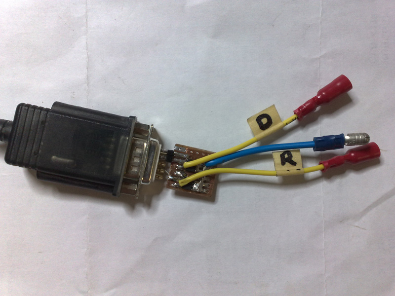

    I gave up on using the PL2303X IC directly and tried a USB com port that I had lying around (also prolific chipset).
    The RS232 driver IC on the USB - serial converter solve the problem I was having with startup. Now the DTR / RTS lines sit at 0V during startup, and -6v when initialised. Both of these states will not drive a FET = problem solved!
    I now have a very simple circuit consiting of a PL2303X based USB - serial converter and 2 infineon BSP742T highside FET drivers as outputs.
    SerialSwitch is in my startup folder, and sets DTR high to power up my amp when it loads.
    I have added commands to my radio button to power the antenna when the radio button is pressed, and put it back down when "audio" is pressed. This is obviously done on the RTS line. works a treat!
    Just want to say a big thanks for this software. my antenna used to clip my garage door every time i started the car. Now it is only up when its needed!
