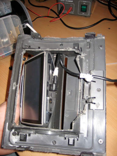

    Today, I devoted the TFT.
    Actually, I just wanted to rebuild an open frame monitor beautiful, but when I learned that it
    The rear view camera would not work, I decided for the CTF-700H.
    And I had LUCK! The display fits really well into the double din hole! Only at the
    Rear climate controls, I had to do something to cut away from the housing.
    Then I built a retaining device which is to the existing screws in the console
    The buttons by the LCD, I have provided with long cables. This I then on the shelf
    The TFT hidden installed:
    In the end, the result can really see!
