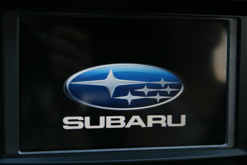

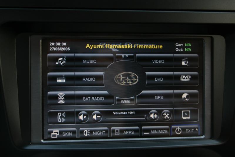

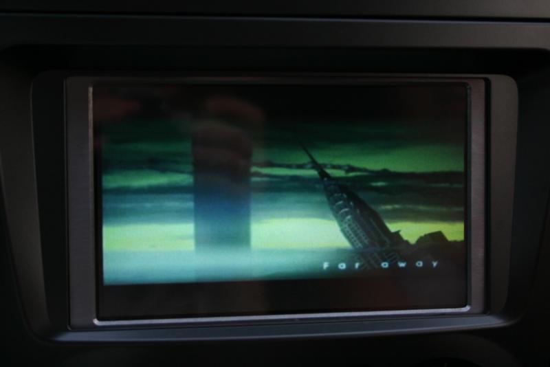

    Here's some more pictures of the actually functioning CarPC.
    Wide-angle View:
    Boot Screen:
    Main Menu:
    Music Menu:
    Video:
    The Car (okay, so I like it enough to plug it twice - sue me :P):
    Of course, GPS works too - I just wish I could get rid of the damn Microsoft logo pointing out to the world. Might have to put some masking tape on it or something...

    phc: I did the boot screen using AWBMTools - I took an EPIA BIOS and replaced the Award logo with a Subaru logo, and set it to "Show Logo on Boot". Worked quite well, though it's slightly off-center vertically - but that's no big deal, since it stays on the screen for all of a few seconds.
