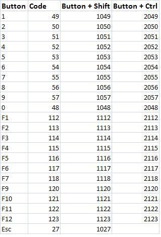

    While working on this project, I compiled a list of keycodes. I thought I would just through them in here in case anyone would like to use them.
    Number Pad
    A-Z
    Upper Keyboard
    Other
    That's a great reference, but like BlueZX3 said in your DOUBLE POST, you left out the Button SHIFT+CTRL as well as the Button ALT, Button SHIFT+ALT, and Button CTRL+ALT character sets. I use the CRTL ALT sequences frequently cause most other programs don't.

    I didn't know about the Button SHIFT+CTRL, Button ALT, Button SHIFT+ALT, and Button CTRL+ALT character sets. I'll compile a list of those when I get some more time. It may be a while, that's a lot more buttons. Good to know.
