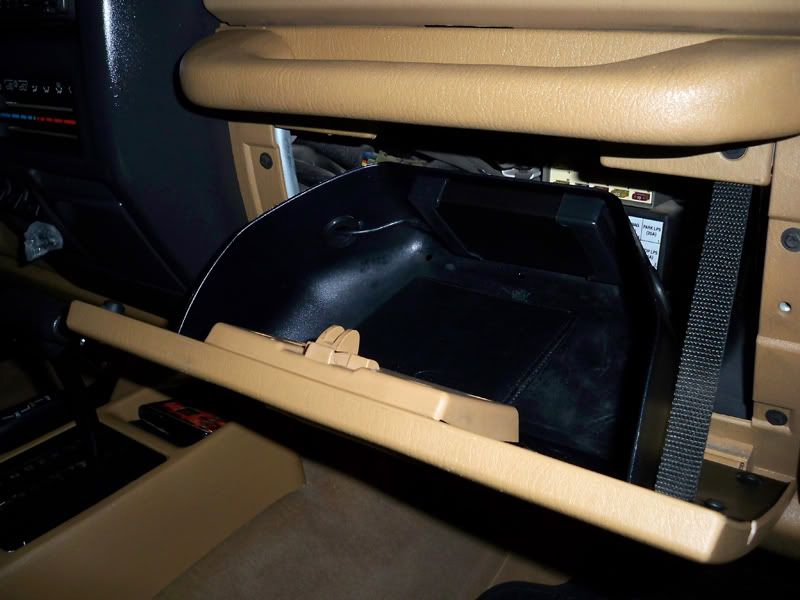

That makes sense Paul, thanks for that. I know what you mean. I have a 500GB next to my tower that I KNOW would be of no use in a vehicle.
But the Western Digital HD I'm running is smaller than my hand, thinner than a pack of smokes, and is USB powered only. So it kinda throws that out the window I guess.
It starting to seem that I might just be forced to put up with it unless anyone can figure it out. I WOULD just use a standard Thumb Drive, but I think they only go up to 16GB, and that won't fit all of my music on there @ 320kbps. There might be some 32GB Thumbs out there now, but they are probably still pretty expensive. The 160GB HD that I'm using only cost me $60 so I thought that was the better route to go. It works great with my PC, just having these little problems with the Car Stereo. I hope I can find a way to solve them.
I'm wondering if I have a reset button on my HU, and if that might solve the problem??? If I remember correctly, I didn't start having these issues until AFTER I started switching the SOURCE over to radio at one point. To be honest, I don't even listen to the radio really, I just wanted to see how clear the stations would come in on the new HU. What do you think?
