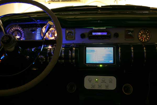

Here is how it look in my car today. I am rebuilding the whole system to use StreetDeck and some of the gear from Phigits.
The LCD
The Phigit LCD will sit just above the original 5 radio control buttons. I will cover the LCD with a clear thin glass or plastic. Paint the interior of this glass or plastic black except where the actual characters display. Leave clear area for the LED’s. We will label the buttons on the interior of the glass.
With the unit turned off, it should appear with only the alarm LED lit:
With the unit turned on:

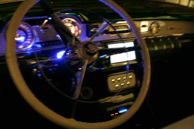

There is nothing like pushing a button. Touch screens are cool, but I'm old fashioned as far as needing to push buttons! The Phidget LCD is still sitting in the front seat waiting for me to have time to tear my dash apart and put it in (about 4 hours) and then put it back together (another 4 hours).
Here is a blurry photo from today:
I need to quit drinking so much coffee!

Better photo.
