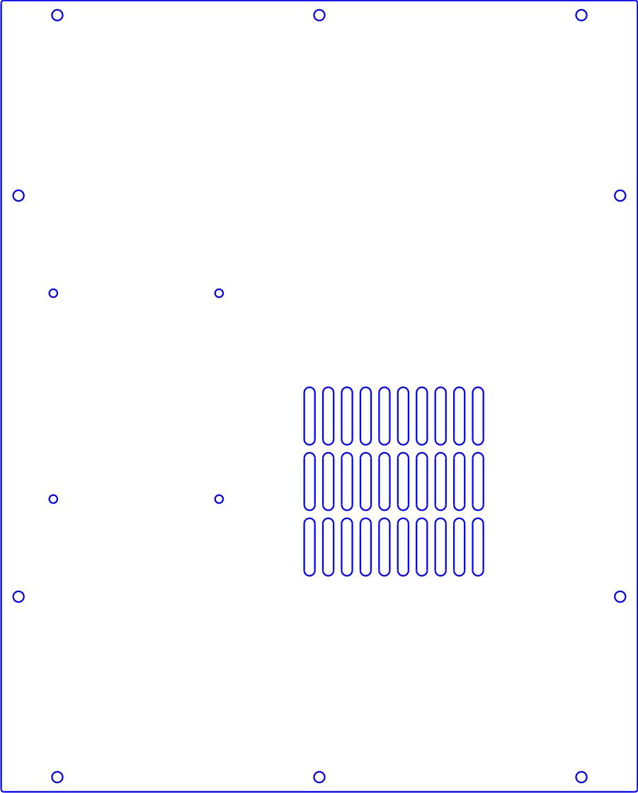

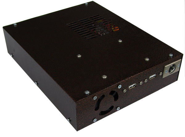

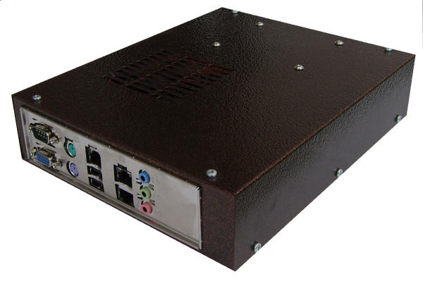

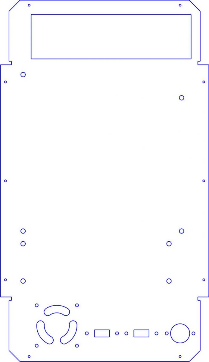

Creation of boxes for the car computer
Drawing (eDrawings Viewer)
Drawing PC case (JPG, DXF, CDR)

Hello,
Looking very good
Can you please name those drawings to english name before you zip/rar them.....then post links again.....otherwise windows cannot extract.....
Will appreciate !

corrected files
