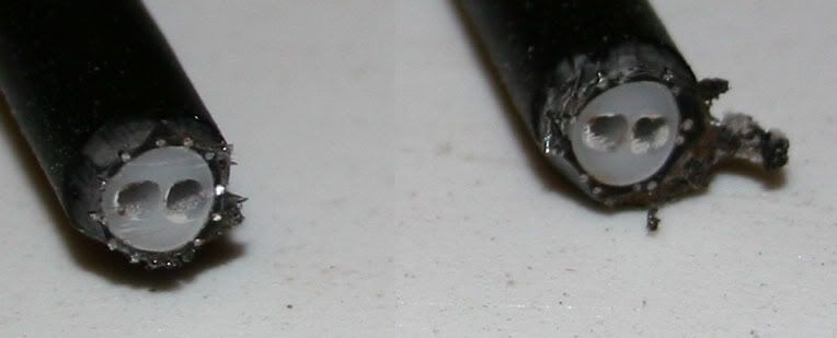

Just an update, I had a talk with "narandomsortofw" about the temperature cables. He took it apart and the sheath was actually divided down the middle to keep the 2 cables from rubbing against one another. This is a bit different than what I thought. I ordered a cable from the dealer and should get it in a few days. I'll post up some pictures and I'll try and find an easy and reliable way to extend it.

OK, after some ordering difficulty I finally got the climate control cable in. I promptly took it apart and snapped photos. The part number is #10418042 and it is about 20 bucks from GM Parts Direct.
There is a small end that attaches to the knob and a big end that goes under the dash on the passenger side. Just drop the plastic foot panel under the dash and follow the cable. It is held on with on screw.
The sheath holds one long cable that has the ends crimped with lugs on the big end and a crimp in the center so the knob can grab it. The whole cable is under tension from the spring on the big end. The sheath is also divided in two to keep the 2 cables from rubbing against one another. I doubt that makes any difference and a single large holes should work just as well. How much rubbing do they actually see anyway?
I think I have a good plan of attack to lengthen this cable as my old idea won't work. I'll leave that for the end.

The key to this design is that the cables are under a lot of tension from the spring plus you don't really need a dual hole sheath to keep them seperated. I think I can cut the sheath (already done) and add a length of bicycle cable sheath in the middle. Get both outer diameters roughly the same size and slip a 4" or so length of copper tubing over the joints and then crimp (or maybe glue) them into place. The sheaths will be pulled together anyway from the cable tension and the tubing will help keep everything lined up and prevent kinks at the joints.
The actual cable can be bought at a local hardware store. Just need a good legnth of stainless cable and some tough, small crimps. I'll crimp the midde first and then run the ends through. then cut to length, get the knob centered and then crimp the ends and add the spring. In theory it should work.

Quote: Originally Posted by narandomsortofw View Post
Well everything in the pictures you have is what I tried to describe (because i'm lame and don't take many pictures), but hopefully it works out.
I still can't figure out if you popped the smaller disc out so the whole cable can be replaced or if you left it in place and just extended the stock cables.
Is www.push-pull.com completely replacing your wire cable? If so they must be popping that small disc out. What exactly did they say they can make? Are they lengthening the sheath or did you already take care of that? Are they just making a new wire and hooking it all up under tension so you can just install it and forget about it?
Are you sure you don't want to try my idea first? I think the center crimp won't see much force so a simple steel or hard metal crimp should do. The ends are going to see more tension due to the spring (I think the factory used more tension than needed. That air flap moves easily) so I think I will add solder to the crimps and cable to give it extra strength.
As far as DVD players go, I don't have one in the car. I'll put a slimline in eventually, probably in the glove box. I pretty much listen to my music from the HDD. I'm getting a little bored with my old stuff, so I'll stick a XM unit in there soon.
The climate controls will fit in the center console along with my radio-faceplate-sized Alpine controller. I think it will work out well. Plus it will keep the passenger hands off the AC knob.

The way I originally did it was similar to your idea. Yours is much more planned out though. I called the guys at push-pull.com and they said they would let me know what they could. So, I am just going to send it to them and let them have at it. If it works....yay. If not....well I will figure something out. I my screen installed now and my the rest of HVAC is in my center console. It took a good amount of time crimping all those wires for the HVAC, but it all works. I will post pictures soon. I still need a motherboard, hdd, and power supply and I should good.
I want to see how you get the tension on the cable. I am curious on how you'll do it.
