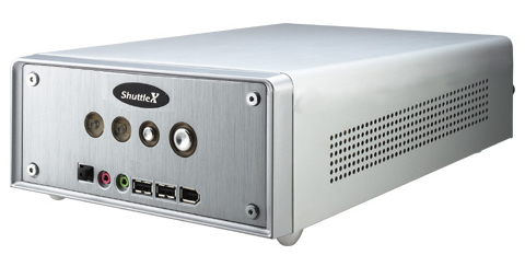

For the base of the PC, I was thinking about taking a Shuttle unit: http://us.shuttle.com/specs_access.asp?pro_id=284
The harsh part comes in fabrication: I'd probably junk the stock PSU and use an Opus 150. I could cout the Shuttle case WAY down (so the only drive bay left is the 3.5" HDD bay), use a slim CPU cooler and mount a couple 80mm fans on the front for cooling. That would leave the Opus OUTSIDE the case.
(Shuttle pic for reference and visualization: Picture it cut down so there are no drive bays!)
That front-mount board could be handy, with the USB and lights. I have studied one of these things in my local Fry's and I believe I can cut the silicon board so I can use the parts I want (lights, USB) and leave the parts I don't care about (Power button, audio jacks). I'm thinking a dash-mounted reset button might be a handy thing, as well.
One thing that this unit has that is truly appealing is the dual video outs. I want to have an overhead monitor for larger maps in GPS, DVD output, Visualizations from WinAmp, as well as being able to comfortably do system maintenance, burn CDs, game, etc. It would also allow for ****loads of RAM (1.5GB), since the onboard video shares system RAM. For that, the mroe RAM the better.
The harsh part comes in fabrication: I'd probably junk the stock PSU and use an Opus 150. I could cut the Shuttle case WAY down (so the only drive bay left is the 3.5" HDD bay), use a slim CPU cooler and mount a couple 80mm fans on the front for cooling. That would leave the Opus OUTSIDE the case.
Well, for the sake of those that have no imagination, and as an excuse for me to play with Photoshop, here's a quick chop job:
Perhaps this will also get this thread back on topic.
