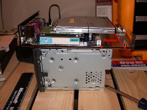

I have a hack that I am propose for the Travla C-134 on this page at my site:
http://www.swooby.com/z/navpc/computer.htm
It's a tight squeeze, and cooling might be an issue, but it might be worth checking out.

I still say it is possible to do this...
...to this...
...and have a 1-DIN computer, but again it would require moving the power supply externally (which shouldn't be a big deal).

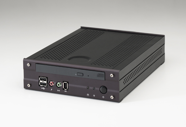

I like, who makes the case and where can I find it ?
Terran
Casetronics - http://www.travla.com
It's model C-138.
It is not available yet, but it will be very soon.
I think it is a bit too wide to be a true 2DIN unit.
