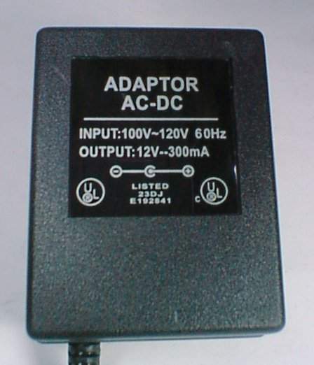

and the picture of the power supply said center positive as well.

Quote: Originally Posted by R32 JUhl
http://www.ksoffice.com.tw/ebay/US/C...weradaptor.jpg
Hmmm... to me that says tip positive, outside negative...
you're right , I closed the picture down too quickley and it must of been a blur
:cough: assumptions
