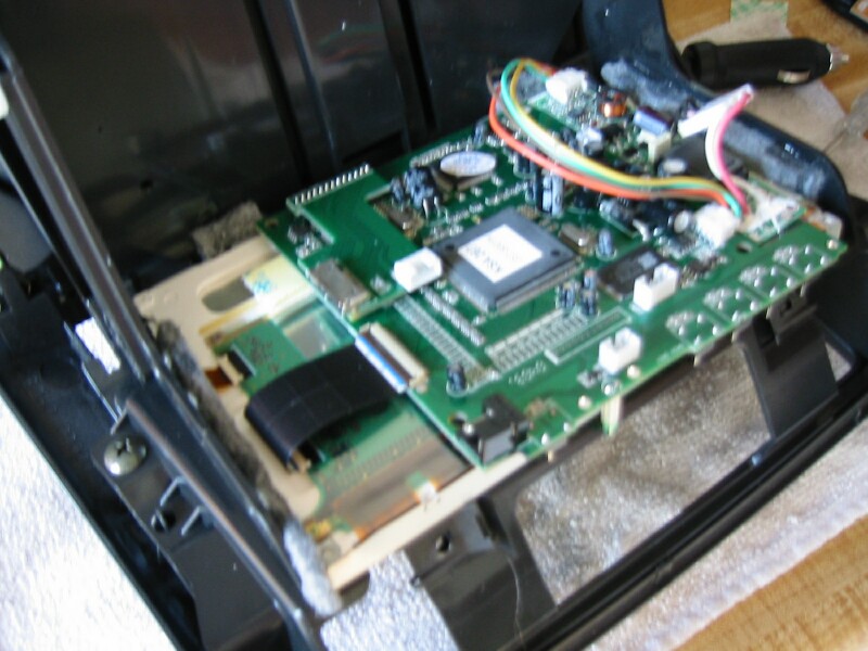

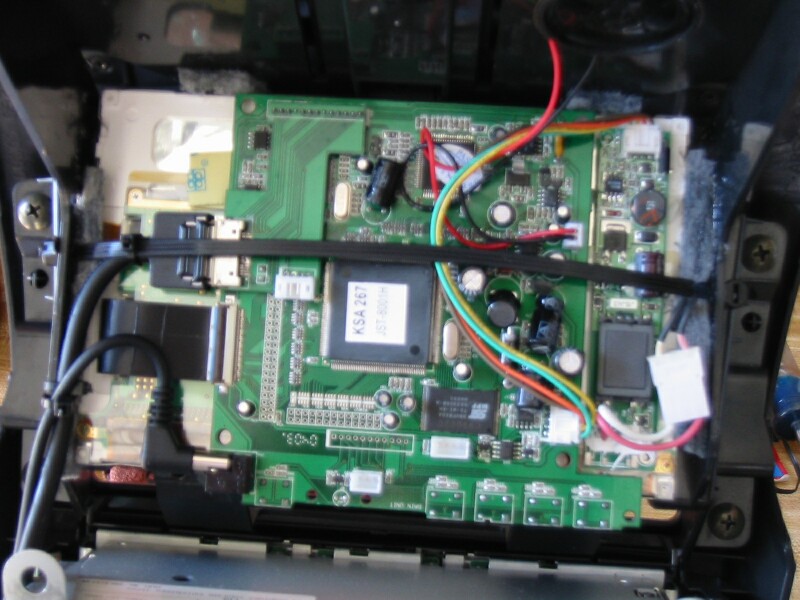

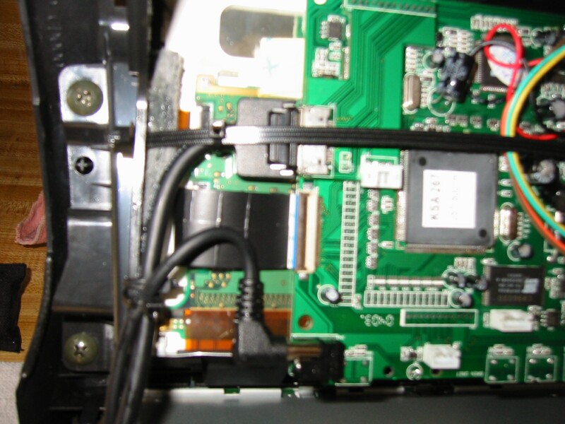

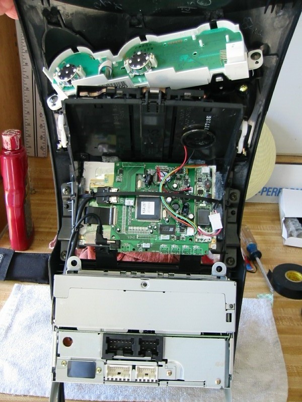

Cars without nav should just use the xenarc screen.
In a few weeks I plan on replacing my nav screen with a xenarc.
The nav screen is just too fuzzy (due to cheap VGA to composite scan conversion built in to the motherboard), and the xenarc is less than half the cost of a good scan converter.
I plan to use my nav screen's mounting brackets to fix the xenarc in place.
Removing the $2,000 nav system and only keeping the brackets makes those some very expensive mounting brackets!
Heck, at that price I could buy a lambo door kit!
http://www.carexcess.com/decah-350z.html
Ah, too ricey.
I'd rather drop in an ATI procharger:
http://www.procharger.com/SPORT_COMP..._compact.shtml
Anyways, the nav screen brackets could perhaps be bought seperately at the dealer or salvaged.
Some people have mounted the xenarc with what looks like zip-ties and epoxy!
<HORROR!>
http://www.swooby.com/z/navpc/pics/d...s/img_2014.jpg
http://www.swooby.com/z/navpc/pics/d...s/img_2016.jpg
http://www.swooby.com/z/navpc/pics/d...s/img_2017.jpg
http://www.swooby.com/z/navpc/pics/d...s/img_2018.jpg
</HORROR!>
I haven't seen a xenarc mount in the Z that I like (or thought was sturdy enough) yet...I hope to do a good job myself (obviously).
