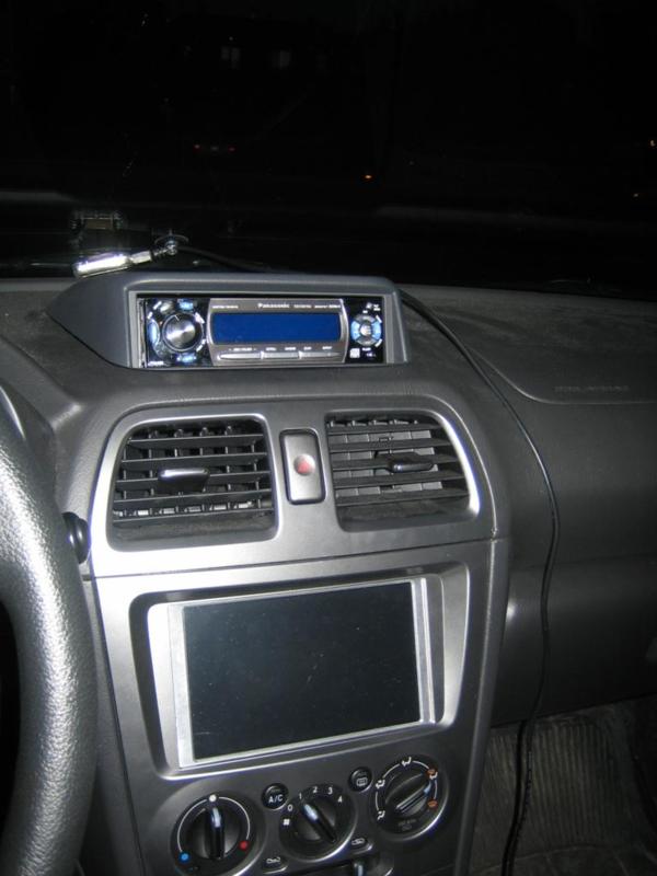

Radio gets relocated:
I'm not unpleased with the new location. It takes a bit of getting used to, but it's overall not bad. Just a bit harder to reach (I sit far from the steering wheel).
Reassembling the dash:
I put all the components back and drove around like this for a month or so while I was preparing all the CarPC parts. This is what it looked like (and the hole wasn't too aesthetic, to be fair )

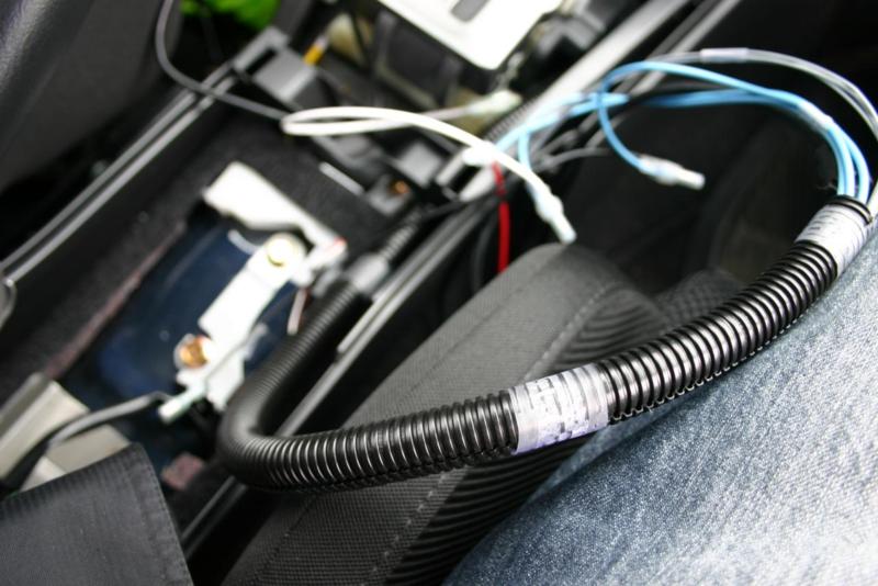

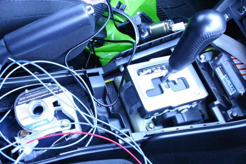

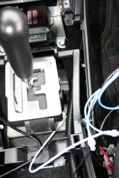

Routing the wires:
After taking off all of the transmission housings (I love how disassemblable my Subaru is), I found that I can route the wires just beside the shifter. I made a custom power extension for the LCD, as well as power for the PC, and housed them in a container wire, and just routed it through here.
Wire housing:

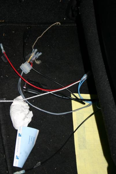

Junk!

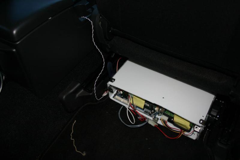

The CarPC is going under the passenger seat. This is all the wires coming out from under it, as well as random parking receipts.
The PC:

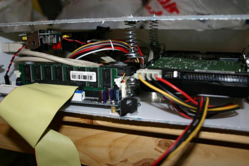

So I started mounting the PC on the plexiglass. It's covered with white protective material, which I decided to keep 'cause the cable mess was too horrid inside - didn't want to demonstrate it. Might take it off some day.
EPIA mounted:
Hard drive and everything else mounted (except power supply) - note that I mounted the hard drive on a shock assembly of 8 springs, bottom ones being slightly harder than top. Again, this didn't QUITE work out as I wanted because I miscalculated the width of the case, as well as the amount of cables above and below the drive; ideally, it was supposed to free-float, but now it's sort of restricted. But it's still better than a hard mount, I think.
Under passenger seat:
(rear cover still needs to be re-attached, and velcro needs to be put to prevent it from moving around... but that'll be done once I'm really done with mounting stuff)
FINAL INSTALL:
So this is what the whole assembly looks like. Don't mind the GPS... it's moving to a much less conspicuous place, and the wire will run alongside the doorsill and under the carpets to the USB port, so that you wouldn't even know that there was a wire there.
Well, that's about it for the install. Final specs are (in my sig, but here they are again in case my sig changes):
