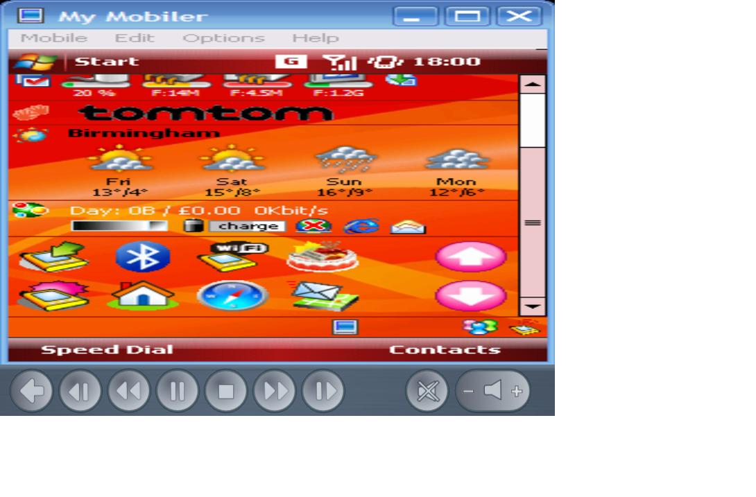

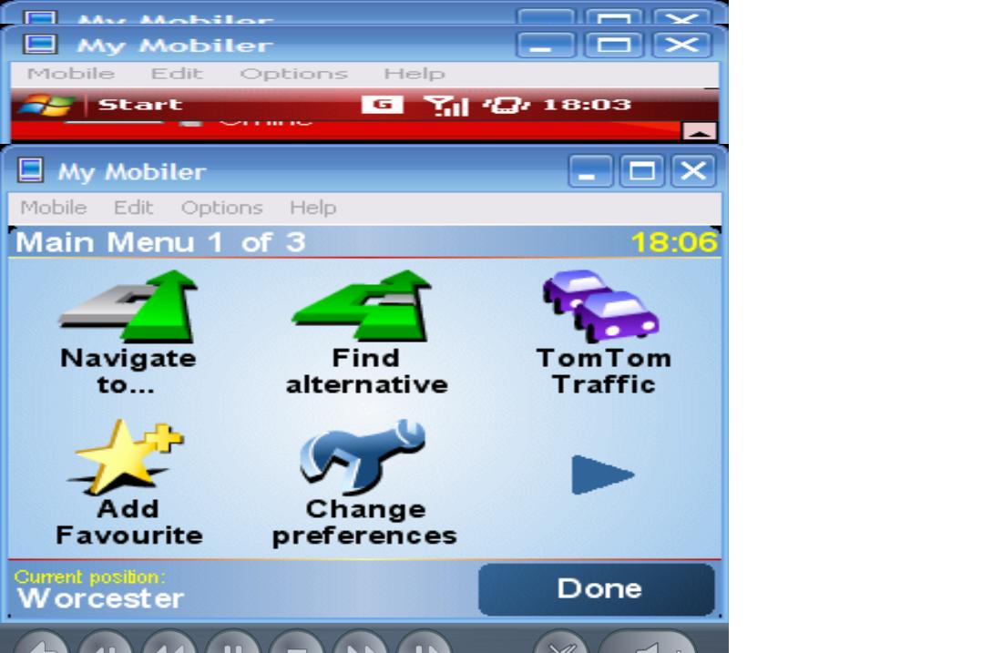

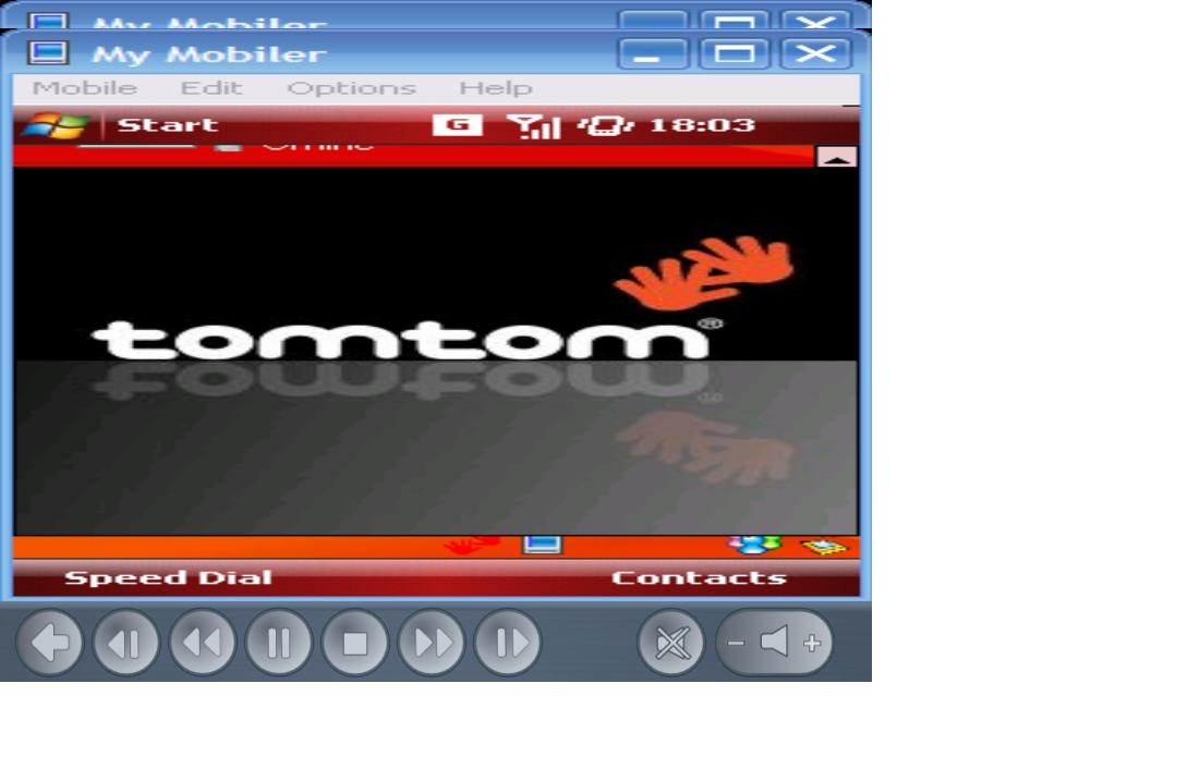

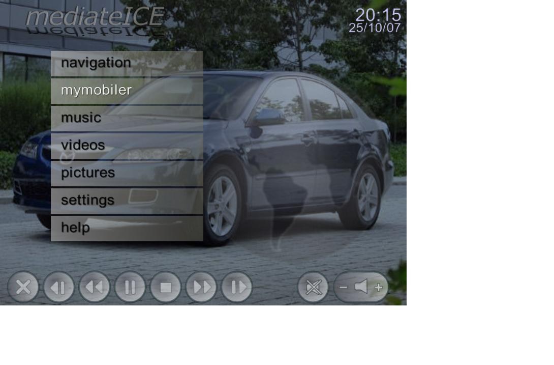

I've been making some tweaks to the default mediate Ice skin to suit my own needs more.
The main change I've made is to create another screen and embed an application called "My Mobiler", which gives me remote control of my PDA.
I currently use this to run Tomtom Navigator 6 on the PDA. I use this for guided navigation as this is probably one of best pieces of software for doing this.
I also have PC Navigator 6 installed and use this with the mediate application. This gives very good close up maps so is very handy for driving around areas in which you are not familiar with, as you can see all the street names around the road that you are currently on.
I have a Sony RM X4S steering wheel controller which I use to control the mediate application. One of the buttons on this I've configured to switch screens. With this I can switch screens very quickly within the mediate application making best use of both Sat Nav applications and also enjoying my music/videos.
The Sony RM X4S I have plugged into a K8055 Velleman USB experiment board, which is configurable from within medaiteIce. Using the mediate config screens I can map which actions to assign to the buttons and whether the actions are repeated if the button is held.
All this means that I can use PC Navigator, TomTom (or what ever software I want on the PDA like Opera browser), also browse and play my music/videos very easily and seemless switch between the screens.
For embedding MyMobiler I've had to create a new screen and added it to the front screen as well as create a external app config file in the plugins directory.
The other changes are more minor :-
1) not changing to full screen visuals screen on clicking on a track or video (I can still goto the fullscreen screen by clicking on the preview window).
2) I've changed the video play list screen to that it has no back ground, so in essence the video plays behind the media list.
3) I've removed date/time on top right hand corner from all other screens bar the main menu.
4) I've made the music preview window bigger
5) I've removed the background to the menu buttons on certain screens.
Some screen shots :-
You can download my amended theme here
I've got some further changes in mind - I'll keep you posted.
