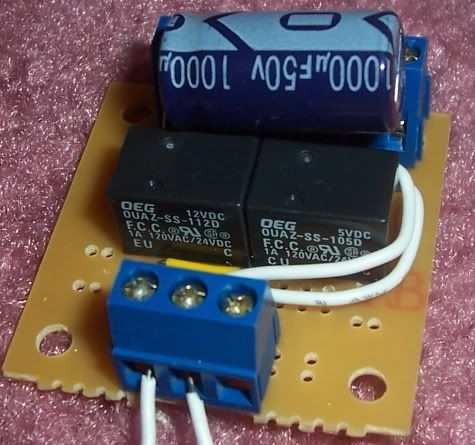

Ok so I decided to make my own module because i wanted power on working NOW and didnt want to wait.
Let me tell you. GO ahead and buy it from W3bMa5t3r
I already spent like 50 bucks making this. Just buying random things. And I still forgot the damn box to put it in.
Switch $2, bought two different ones cuz one looked prettier at radioshack
PCB $3 for two
Relay 12v $5
Relay 5v $5
Relay 12v $5 Yes i bought another relay by mistake...
Wire 100ft $8
Wire 50ft $5
Screw Terminal $3
Resistors $1
Capacitor $4
Power Jack $3
Power Plug $2
and I still need to hack apart a usb cable(Have them) and a case($5?)
radioshack/fry's sucks. Shoulduve just ordered them, or made a digikey order since I do need some stuff from digikey.
The screw down terminals are being used as such.
1 Screw terminal block is for usb
1 Is for the power/ground
1 is for the output switch/bypass switch

forgot to mentian, tested, works great

LOL glad everything is working for you. Building it is half the fun, and to be honest, yours is one of the better I've seen thus far from the folk building their own  but thanks for the sales push lol. good luck with your project
