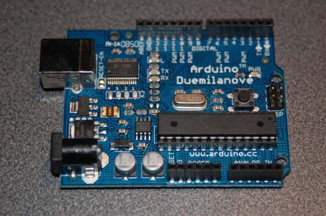

Decided to do something about auto selecting the reversing camera input because Xenarc Support advised me that the auto select feature is not included in this model.
Drawing some inspiration from this thread http://www.mp3car.com/vbulletin/hard...ort-carpc.html I purchased an Arduino controller from http://www.littlebirdelectronics.com/ who distribute them in Australia. This is what one looks like:
See http://www.arduino.cc for more details.
These gadgets are a mini PC designed to talk to the outside world and have lots of inputs and outputs. They are programmed in C and the development environment is open source and a free download. You can see there is a spot for external power and a USB port which is used to download programs to it and to communicate between a PC using the USB as a serial port.
They are an awesome device and I was able to add an external temp sensor using a cheap LM35 IC that worked with Road Runner quite easilly.
Anyway, I need to get the brain to press the monitor buttons to select between the VGA input and the Reversing camera input (eg press input select, Down Arrow, enter key). I will be using four little HFS2 solid state relays to do this.

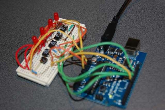

This picture shows my development circuit:
You can see the relays are connected via pin 1 to the output ports on the Arduino via a 220 ohm resistor. Pin 2 goes to ground. Pins 4 & 5 are used to switch the monitors and for testing, I have added an LED to simulate each button on the Xenarc. So from the top down they are input select, enter, up arrow, down arrow. The little momentary press switch simulates the reversing switch.
You can see the LED do light up:
So to sense 12 volt voltages and to trigger 12 volt circuits I will use some bigger 12 relays that can handle 2 amps:
There are two kinds here, one lot has a 5 volt input for outputs Ieg turning things on in the car and the other kind has 12 volt on the input side which I will use to switch 5 volts to the input pins on the Arduino itself.
And finally here is some working code:
