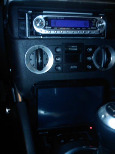

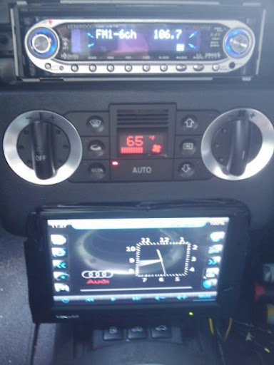

First Test Fit of Xenarc
And through the back window...

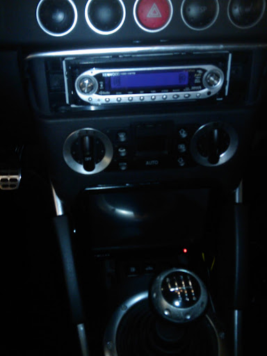

The TT
Better pics to come but it was what I had handy

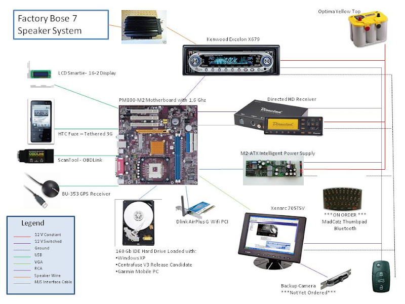

Version 2 has begun. Thanks for the DC guys alot of it got installed this past weekend. We were able to go from a laptop to the PC in the trunk with Centrafuse running in about 3 hours including cabling(and of course a little troubleshooting)
Thanks for the help guys.
I will update install pictures hopefully over the next couple days. Heres the basic schematic though.

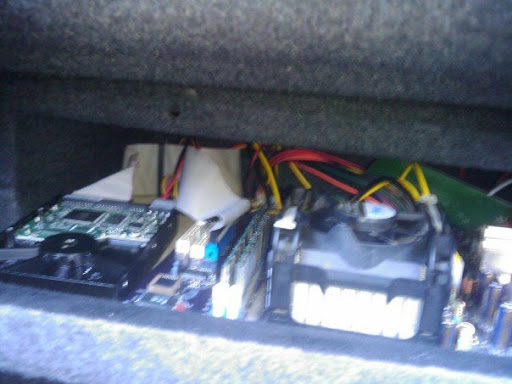

Got the mad catz keyboard in. Nice little keyboard. Tried it on my test PC and it seems to work great and was recognized instantly. Hopefully it does the same in the car. The keyboard is about 3.5" x 2" and rechargeable via usb. One more accessory to run to keep the thing charged.
I know I owe all the guys from the DC meet some pics, I will try to take them this week. I put the cpu and all on a board in the back and moved the gps inside, but I still need to paint the board and secure everything.

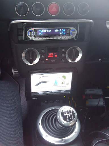

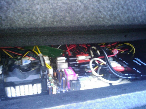

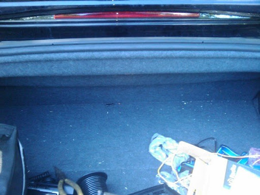

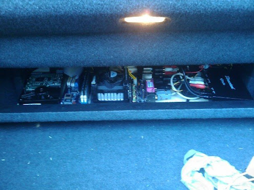

Much awaited photos...
Still need to finalize the mounting and get the board painted so it is not as obvious. The mounting is priority one...

Yes and No. The audio is working fine. I found out the motherboard wanted 2 jumpers to force the sound to the rear inputs instead of the front when it was in a case. The problem I am having is that sometimes the sound does not come back after it comes back from hibernate. I have to exit CF3 and come back in and then it works great.
Still need to clean up some of the wiring and put the rear panel back in but that is not critical for functionality
