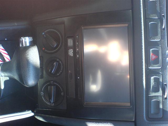

wow i like what you did with the screen. my suggestion is paint the face plate of the dvd player. it will look more stealth and alot more stock...post some pics of how you mounted the dvd player please

Regarding painting the dvd drive, the person who helped me doing the fabric glass told me that there might be a possibility that if we painted the drive it would turn out to another color or that the paint would look ugly because of its surface :/ thats why it was left with the OEM color of the drive

remove the face of the drive. sand it down slightly. and prime it and paint it. trust me i did it to mine before and it turned out great. it will look alot better!

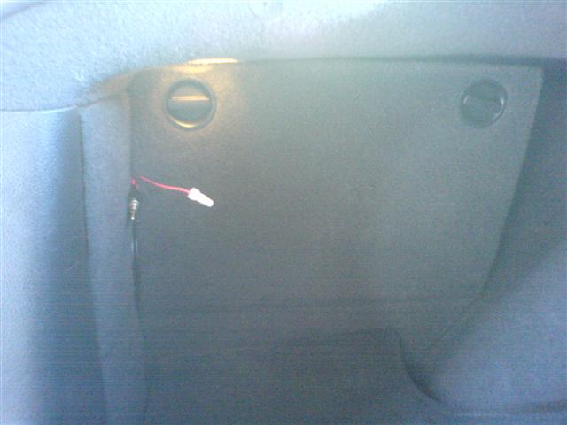

A couple more of pics...

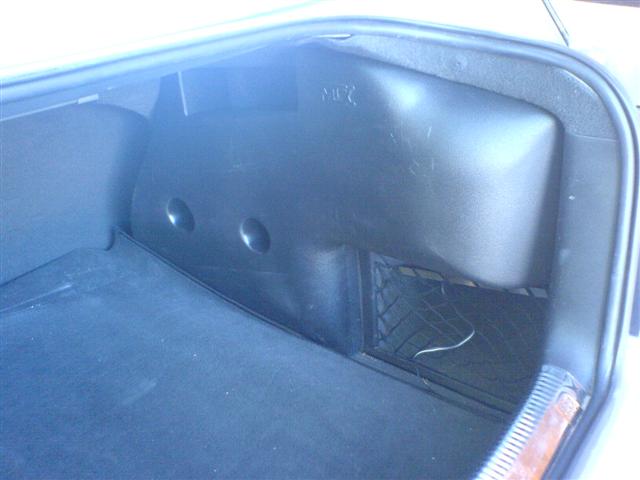

Heres how the trunk is gonna be

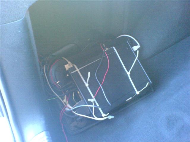

Go I finally did the installation.. I forgot to take the camera with the guy that helped me installing the equipment... I will post some pics on how it looked finished tomorrow...
Regarding of what HU i had, yes it was a Sony MP3 cd player, got it like 2 years ago... (was one of the first that supported id3 tags)
For amps, no im not using the moonson amp, I added a Phoenix Gold 4 channel amp... I might have to consider adding some cooling.. never thought it could do some harm to it..
For now I'll have to wait till monday when I get my new 90 watt power supply, (the one i received first here from mp3car had a faulty remote pin, so I couldnt "turn on" my amps, screen, usb hub and dvdrom, right now I have it with a switch with positive power off the battery.

I bought a spare piece of the dash on ebay (was about 40 bucks) I cutted what I didnt need in order to fit the 7" xenarc screen, onces I adjusted I took the peice to a person who fixes motorcycles (they tend to know how to work with bondo) He just glued the screen onto the dash, and added some bondo to make it look like a single piece (I bought a xenarc case so he could work on that, onces finished I just placed the screen + back cover. I added a piece of aluminium adjusted to the plastic of the piece of the dash.
For how to remove the dash, check Vortex VW Forums (if i recall the name correctly) they have a pretty good guide on how to remove everything. Just be patient when removing it for the first time, it took me like 3 hours to remove everything the first time.. onces u get used to it, u can do it in less than 20 mins
