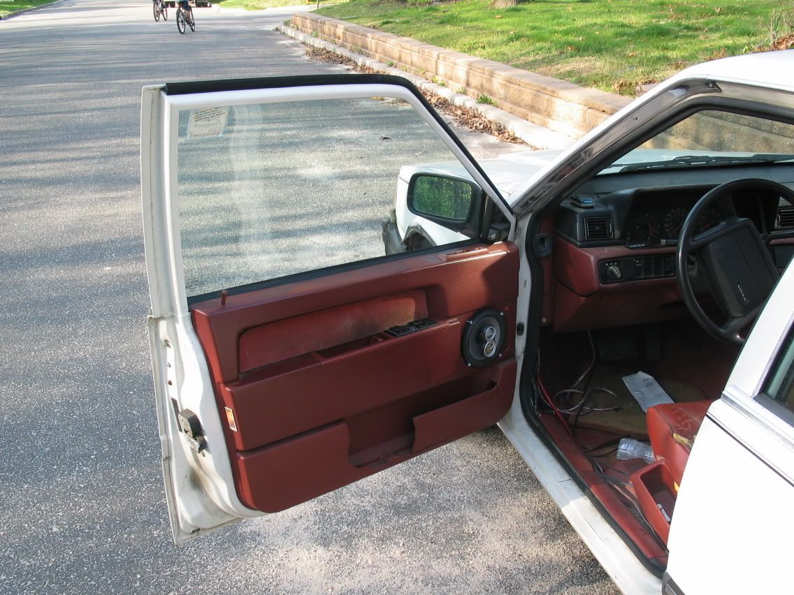

    So here are a few more shots.. The orignal volvo speaker hole was way too small, so i had to buy a $20 metal cutter to do the job. Needless to say, since no one would be seeing this, i couldn't give a crap how it looked as long as the damn speaker fit. It took 2 days, but yeah,
    Took a knife to the rubber groments. I'm telling you, the swiss don't want you touching their cars lol.
    I also had to drill new holes. Then i went to Home Depot and bought some washers and some 8-32 x 3/4" screws. It was almost a perfect choice, and i thank my last job for teaching me so much about screws. No, not SCREWING RAF, screws. I don't work where you do
    I will add grills soon.
    ANd here is the Mess-o-wires. I'll clean it up, but i'm letting everything sit for a bit as the adhesive is setting. THe EQ isn't installed yet, but will be when i go for a good tuning. I still have to figure out a few things.
    All done. yes that lotion on the floor. You do NOT want anything but really moist and soft skin when dealing with sharp shards of metal sticking out every which way. Yeah, i stuck my whole hand in that hole without any protection on but lotion. It's a great lube for many things. Not THOSE THINGS....
