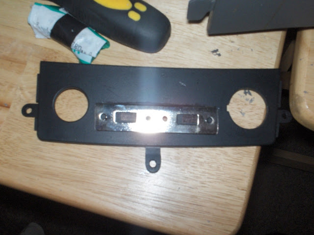

    I wanted to mention about the USB bracket modification as displayed as the photo album cover in the previous post. The chrome looking panel used to the a panel for mounting on the back of a desktop or PC tower.
    The pic below displays how the panel looks before the modification. I cut the L-shape piece off with a metal cutter on my Dremel then cut vertically on either side of the USB holes so it would fit on the front console between my car Hazard button and the USB Cigarette Port Replacement.
    There used to be a black momentary switch on the panel displayed in the after pictures. That's why you see a big square hole. It will be covered by the USB bracket.
    Before:
    After:
    I'm still not done modifying this because yesterday the battery in my drill went dead so today it should be fully charged so I can complete this task from my project.
