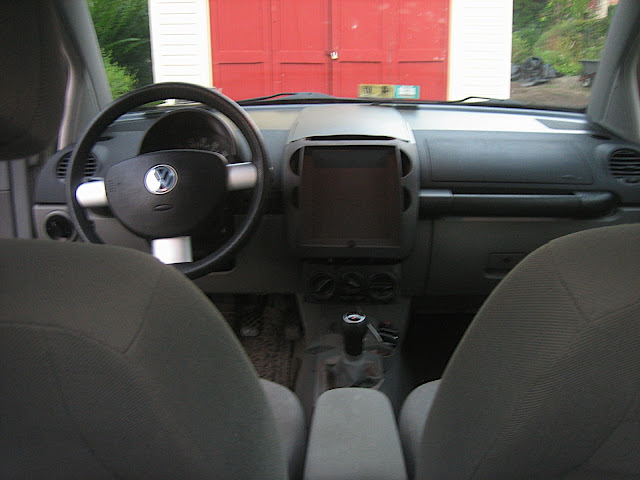

The issue was that making the iPad opening required the heater controls and the hazard lights below them to be relocated. I chose to simply lower everything but that required an all custom fab to contain the controls and lights.

The overall effect looks a bit like this.
http://lh4.ggpht.com/_XEIWmPuHCZs/TJ...0/IMG_3052.JPG

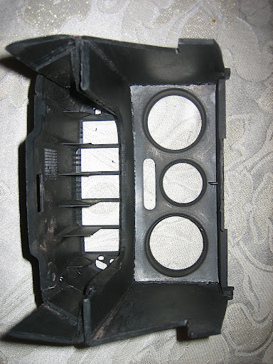

So, what I did was take the heater box and the front fascia for the hazard lights and glom them together. I didn't take intermediate pics of it, but the finished product is below.
It turned out pretty good. It was tricky to combine the two pieces. The existing hazard light box was actually too wide for the heater control box, so it stuck out on each side about 1/2 inch. I carefully sliced each side and shorted them, then glued them back together to make them the same width as the heater control box.
Then, I glued the top of the whole thing to the bottom of the heater control box and used a soldering iron to weld the plastic together on the inside. You can see the two boxes stacked on top of each other in the picture below.
