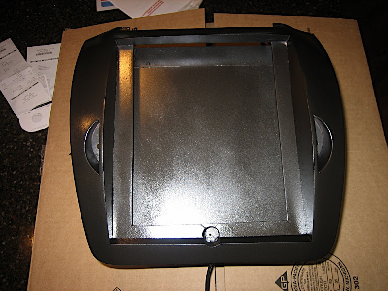

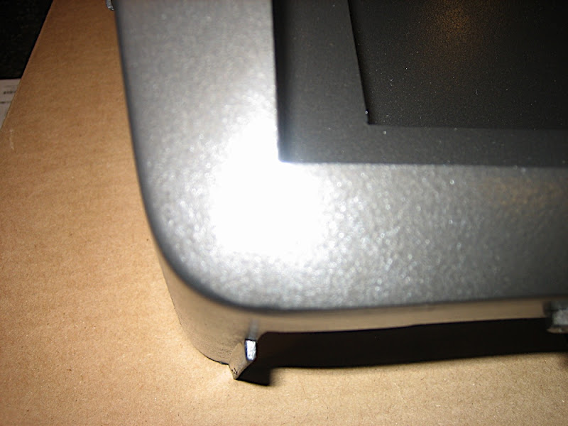

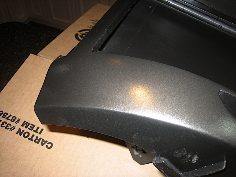

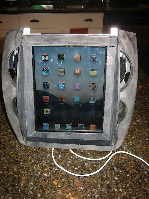

    Today I sprayed a finish coat on the main iPad bezel and it turned out pretty good. Actually, I sprayed a coat yesterday and A) I got slightly too close to the bezel and almost got a sag, which is uncharacteristic for me. I'm usually better at spraypainting than that; B) there were still a very few nicks/gaps that were faintly showing through.
    This morning, I sanded the sag areas - really, they were more like buildups than sags, and put one last bit of spot putty on the faint gaps, let it dry, then wet sanded it with 800 grit paper.
    Here's the main result.
    I've managed to do a reasonably good job of taking care of the gaps that were in the original assembly, here:
    and smooth them out, as you can see here:
    The upper half moons were nearly gone when I put the primer on it:
    and now there's no sign of them at all.
    Joints where disparate pieces came together also smoothed out pretty well.
    If you look closely, there are still some very faint joint lines that show through but using the hammered texture paint helped hide some of the sins. You can see on the right hand side of this pic where the orange glow of the overhead light reflects off the piece that there is a faint line where the different pieces came together.
    All in all, it went better than I thought it would. I managed to go from this rough piece:
    To this finished piece:
    At this point, I'm going to declare victory and move on. In test fitting the heater control and hazard switch box yesterday I came to the conclusion I was dreading. The electrical wires for the switches have to be extended to make them fit in the new positions.

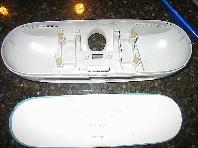

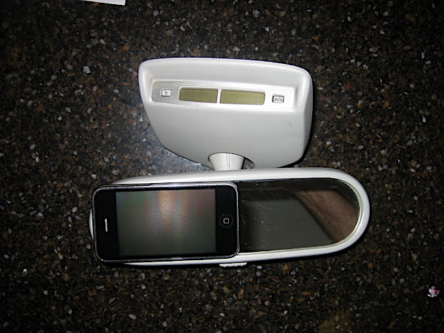

    For quite awhile, I've been considering putting my iPod touch 2g into my rear view mirror. I would load it with music and just let it sit up there and I can control it using a program called tango remote from the iPad. It would be easy to sync/change the music on it as I could just take it out of the rear view mirror and connect it to iTunes in the house.
    I went so far as to buy a replacement rear view mirror on ebay. The mirror shell itself is pretty big and I was thinking I could put the iPod AND the screen from the ex-10 into it.

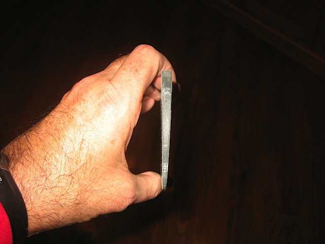

    Cracking open the mirror, the glass is thin and sits at the very front of the mirror. Inside are two things - the mounting mechanism and a light that is the dome light for the car. If I do this, I'll have to figure out where to put a dome light.
    After quite a bit of wrestling, I figured out how to remove the mount and the light. Now, I'm left with the shell.
    The mirror glass itself is wedge shaped and that explains how it works when you flip the little dimmer thing on the bottom of the mirror. It changes the angle and reflects off of the other surface of the glass.
    Next was to remove the Alpine screen from its housing and see if the innards were the right size to fit inside the mirror. The entire bezel was too large.
    Hrmm. Looksl like the electronics are pretty big...
    It will physically fit inside, but that mounting mechanism in the middle is going to get interfered with. Not to mention that I want to put my iPod in there. I'm running out of room fast.
    Any ideas for how to alter the mounting mechanism to allow for room inside? Maybe an external cage for the ball joint....?

  10. #40
    Nov 2007
    112
    If you're the only person who drives the car, could you just make a permanent mount in the position you need it in? The other solution, as you said, would be to make everything external. This may sound strange, but you may be able to use a swivel socket for a ratchet wrench to do this.
    ^^this is the best picture I can find, but what I had in mind only has one ball bearing. It should be rigid enough that you can adjust it and it will stay in its place. To maximize the room in the casing you could lose the ability to flip the switch and change the mirror setting, but who uses that anyways?
    As a side note, what would be really cool is if you could replace the mirror glass with a one-way mirror, so you could mount the iPod directly behind the mirror and you won't see the screen unless it's on. Sort of how this screen protector works:
