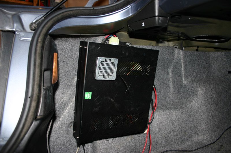

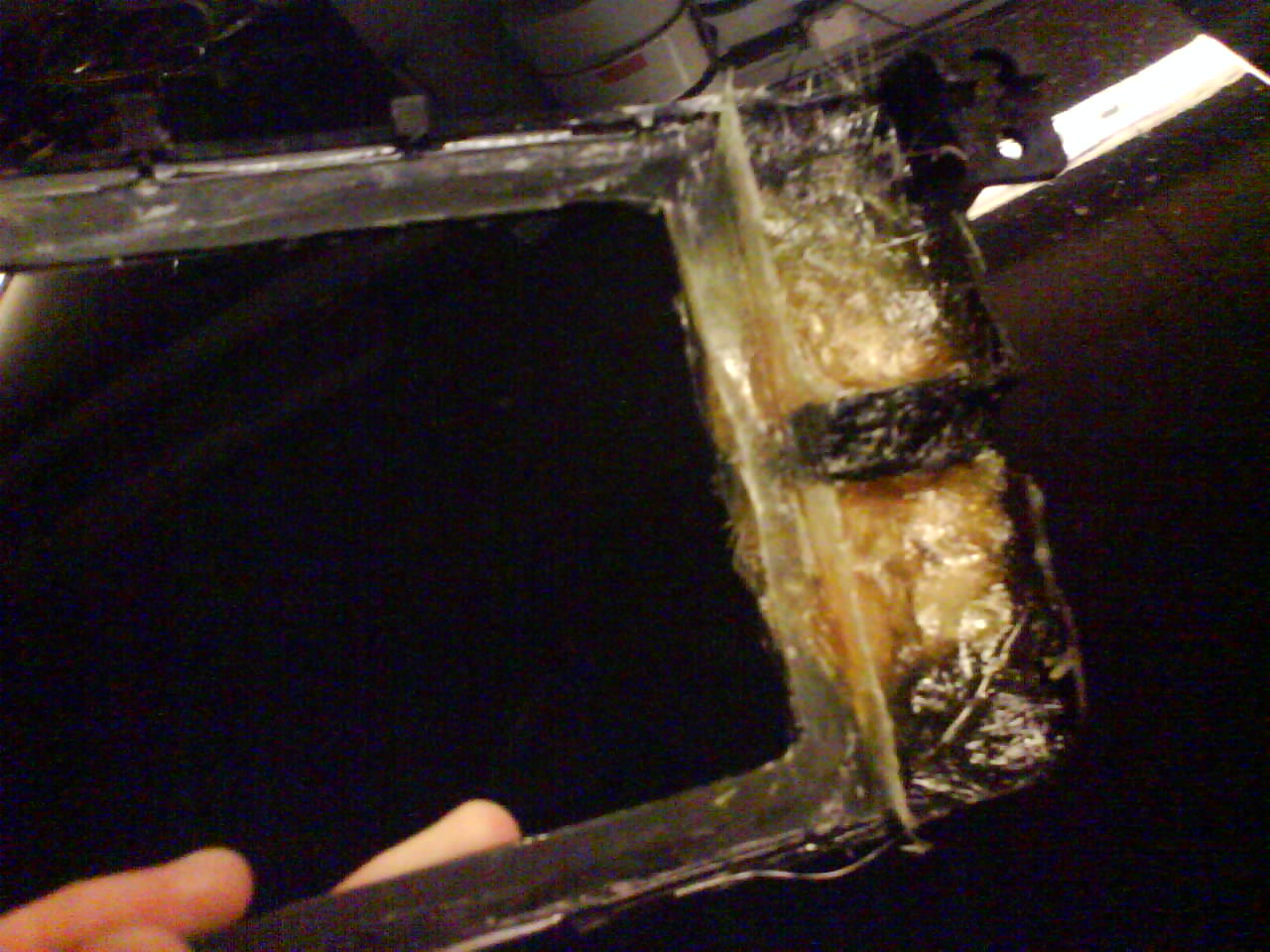

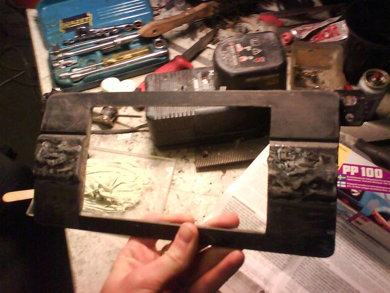

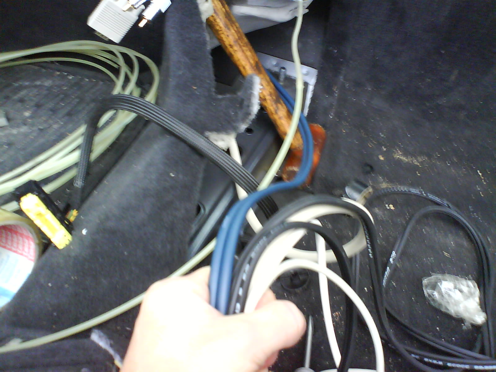

    Worklog:
    2005-06-10: Speakers installed

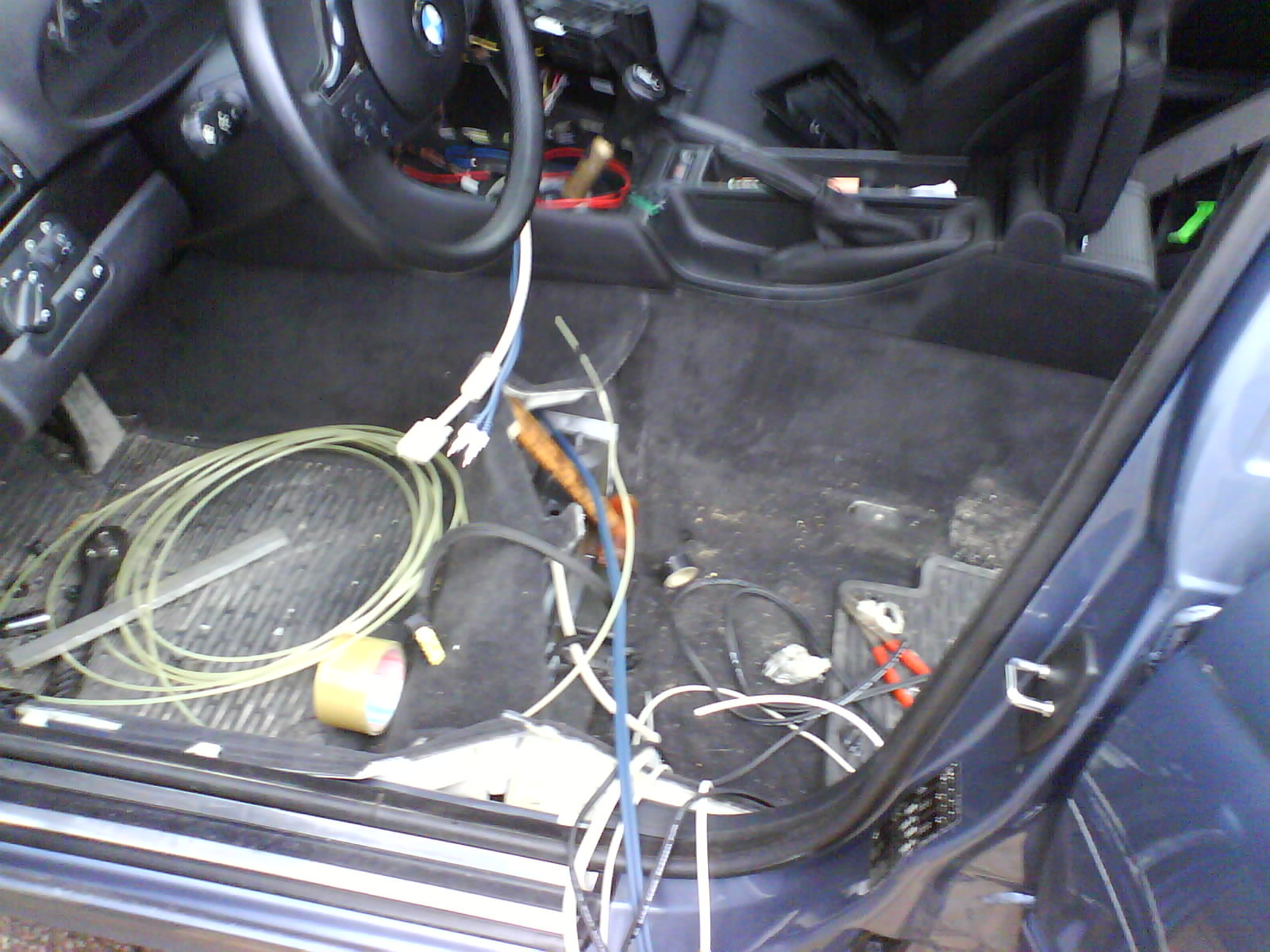

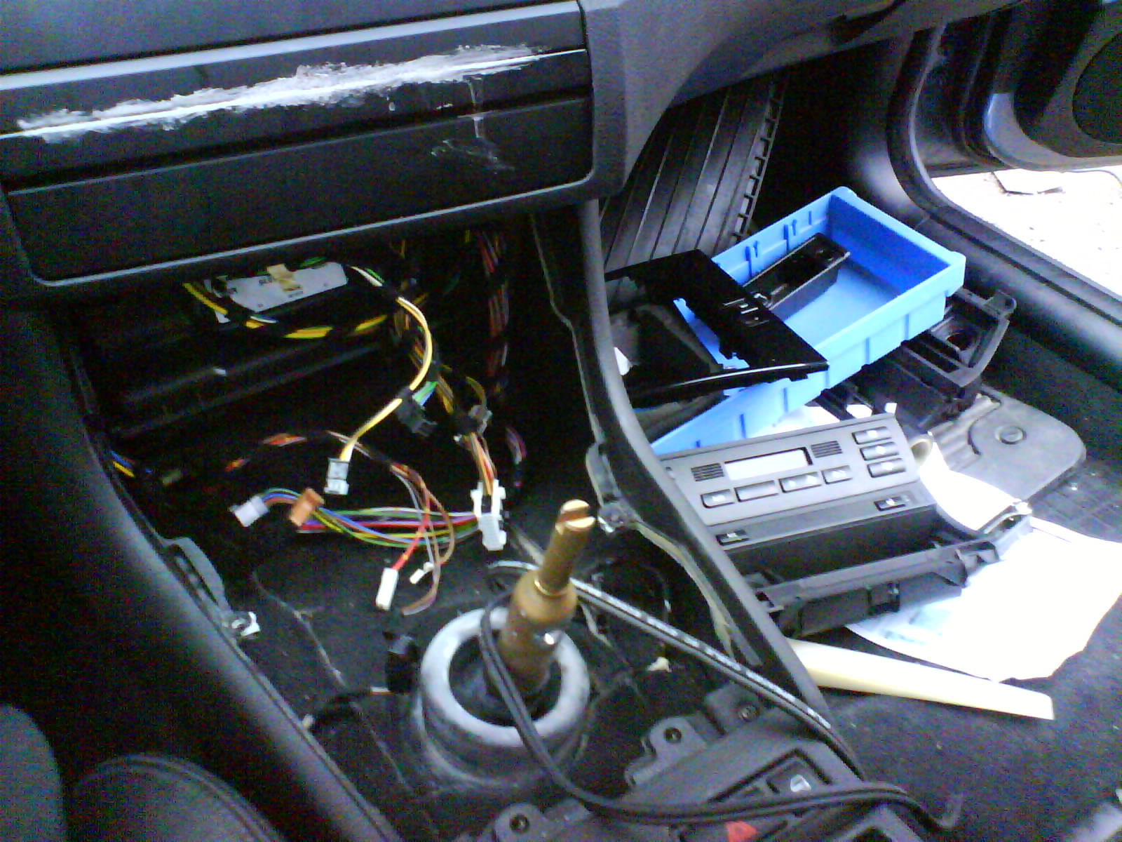

    2006-10-12 -> today: Installed all cables, started work on screen mount, mounted AMP and computer.

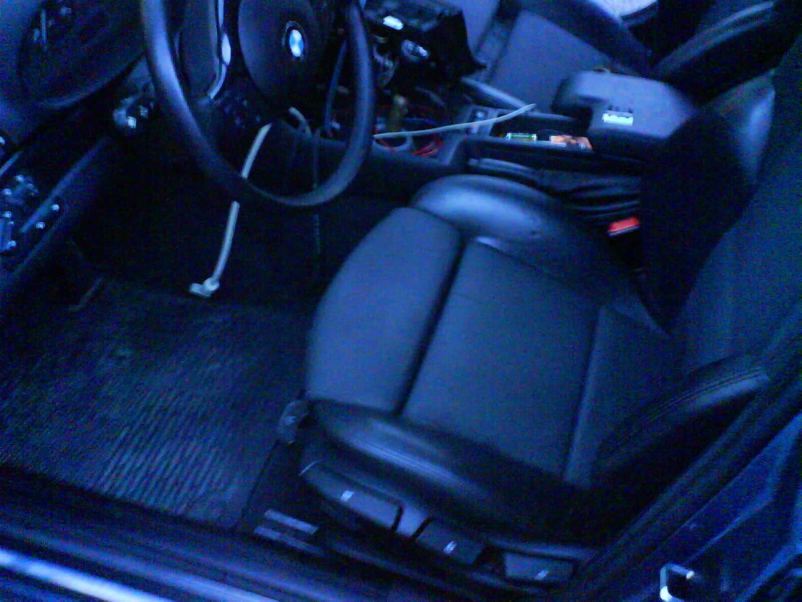

    Pictures (sorry for the bad quality)

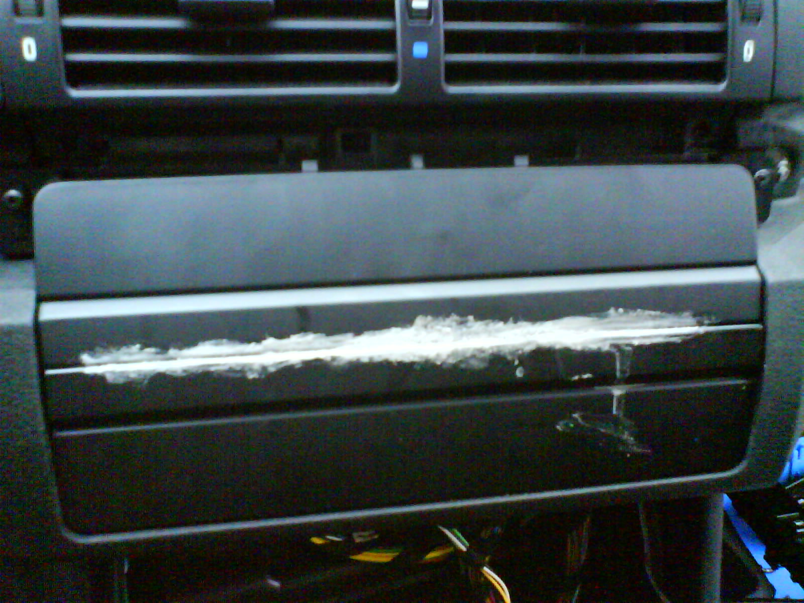

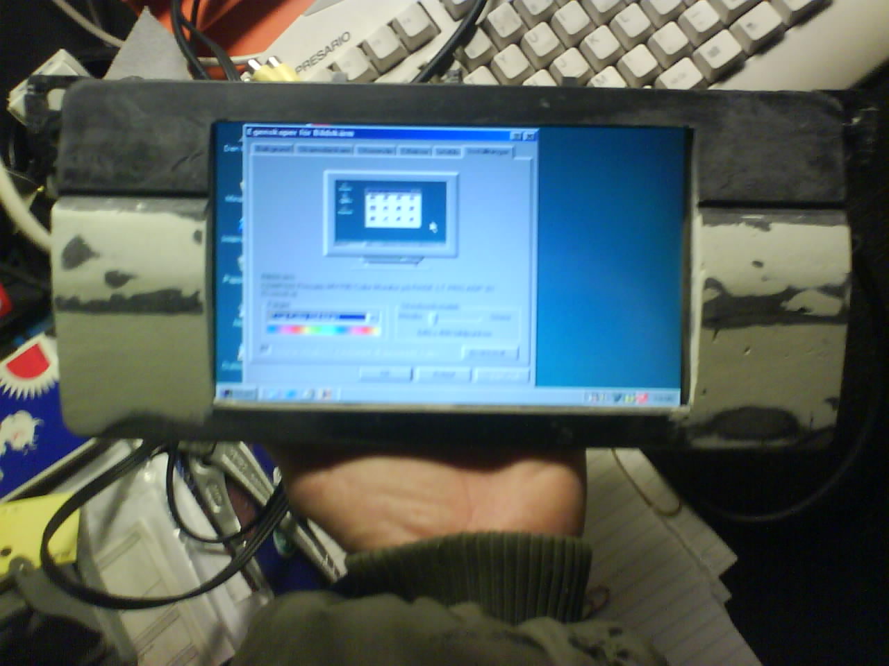

    Nice job Thomas. It will be very nice bezel when will be finished. I am curious about the bottom part of bezel, where did you find it?

    Both upper and lower part are the same, BMW part used if you don't want any radio at all. I trimmed the lower one down to size (mounting brackets etc) so that it fitted in the bottom half, then I glued the two pieces togheter using some CA, when it had cured I removed them from the car and used acetone + ABS plastic to fuse the two toghether.

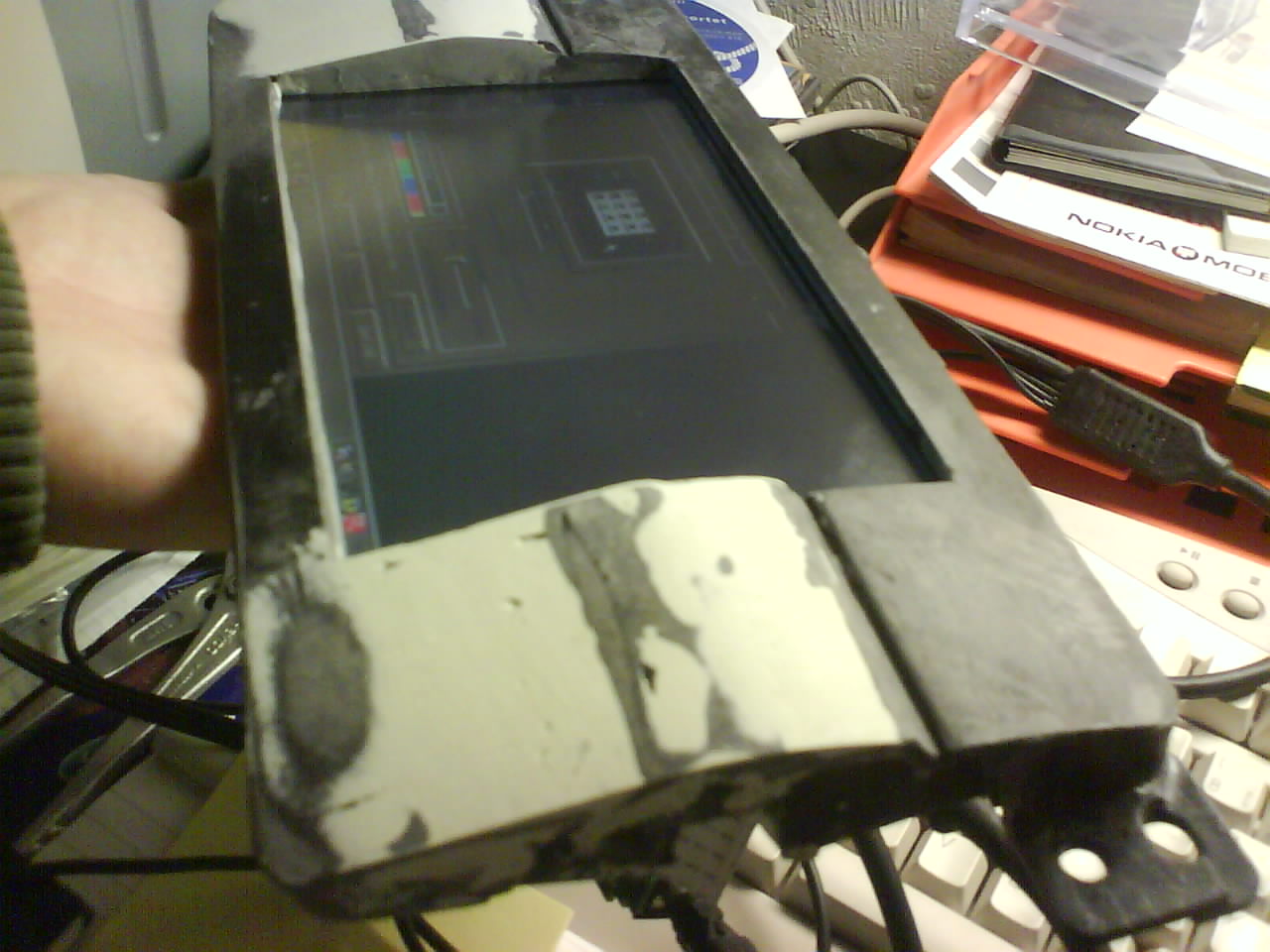

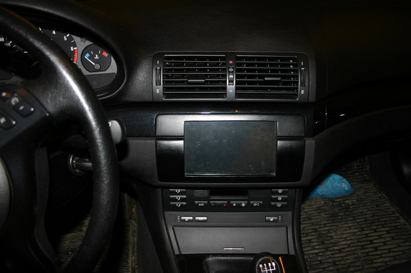

    Today I removed the computer and screen from the car and managed to take som pictures of the finished install
    The bezel turned out great.

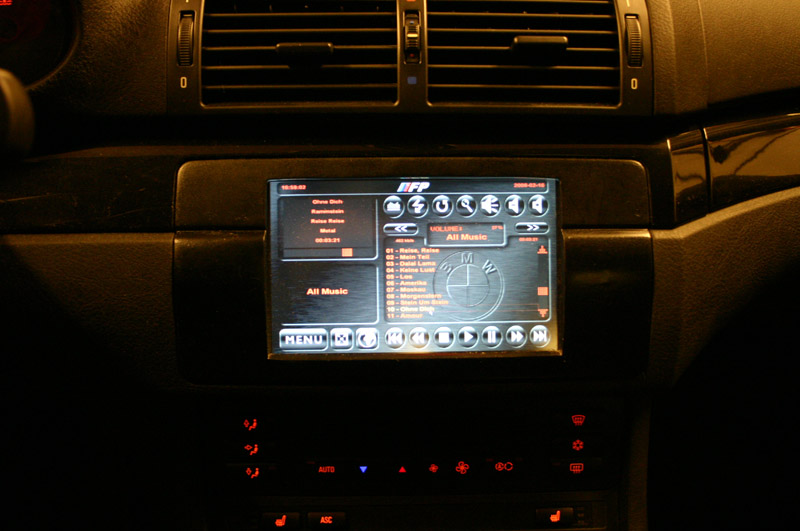

    Bad picture, but frodoplayer (Installed 4 years ago, installed in car 2 years ago) have worked great.
    Computer mounted in rear left corner
