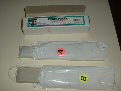

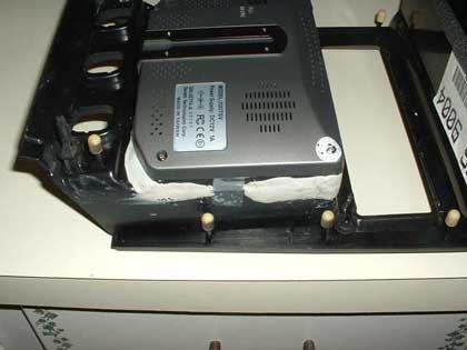

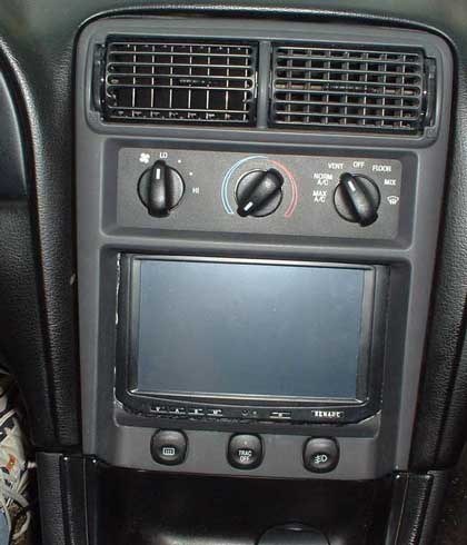

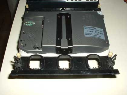

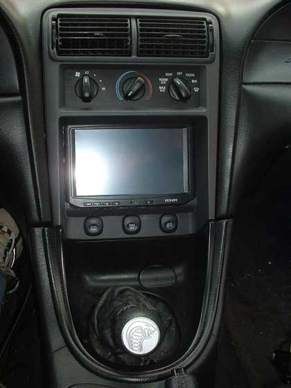

screen is mounted ... pics to come tomorrow afternoon.... the epoxy putty works great ... the consistancy is like silly putty .... remove the same amount from part A and mix with part B .... with your hands! ..... then put it were ya want it ... so far so good i molded it with water on my hands ... worked great .... dried in a little over an hour ... i couldnt wait and mounted the bezel .... now i need to find some black interior paint to match the interior so if you guys know of the correct interior paint ... drop me the info...

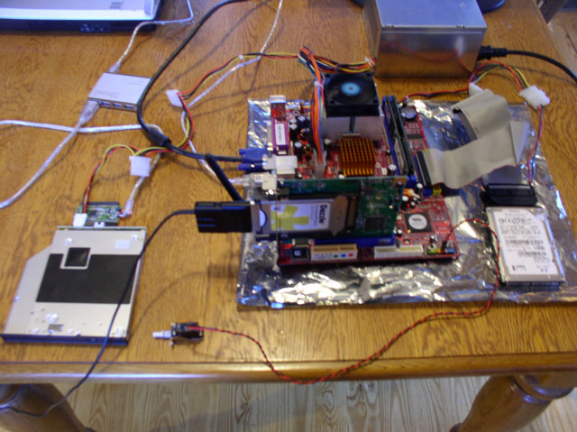

also acquired a new toshiba laptop with broken display.. so im looking into that as the pc. researching the DC-DC setup and how to control startup and shutdown. more to come.......:)
