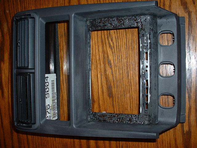

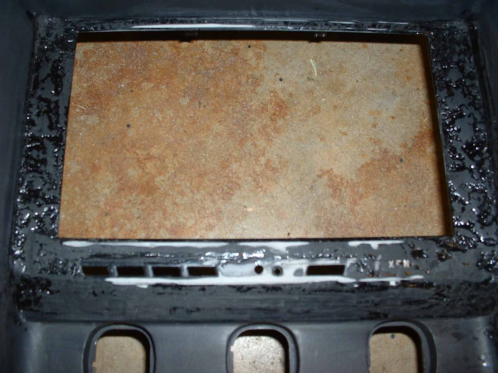

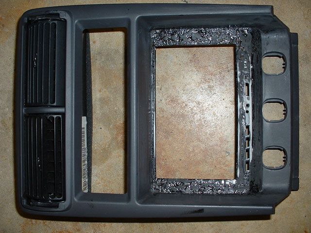

sanding .. .sanding ... dremel .. and more sanding....
seems the porpatch does work ok..... its easier to sand than i thought... and the tuff spots i used a dremel.... the cool thing is that the gloss black sands down to a grey that actuall matches the bezel color.....
http://www.crabbnet.com/cobra_pc/bezel_sand.jpg
the gloss black helps notice the low spots .. looks worse than it is ... to touch the low is onle slightly low .. less than a mm. so im going to fill with bumper filler from bondo .. and sand that down .. at least thats my plan at the moment.
http://www.crabbnet.com/cobra_pc/bezel_sand1.jpg
and one more after a little bit of sanding .. and removing the high spot at the bottom right with the dremel....
http://www.crabbnet.com/cobra_pc/bezel_1.jpg
man its hard not to rush.... patience grasshopper..... lol :rock:

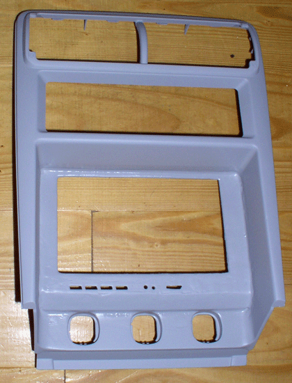

a little bezel progress... im learning.. and yes its been over a year since this project started....
i added some filler primer... couple more coats to go. so far so good.
http://www.crabbnet.com/cobra_pc/filler_primer.gif:eek: http://www.crabbnet.com/cobra_pc/dup_bezel_two.gif
ill add another coat tomorrow.. and maybe ill be ready for more sanding
